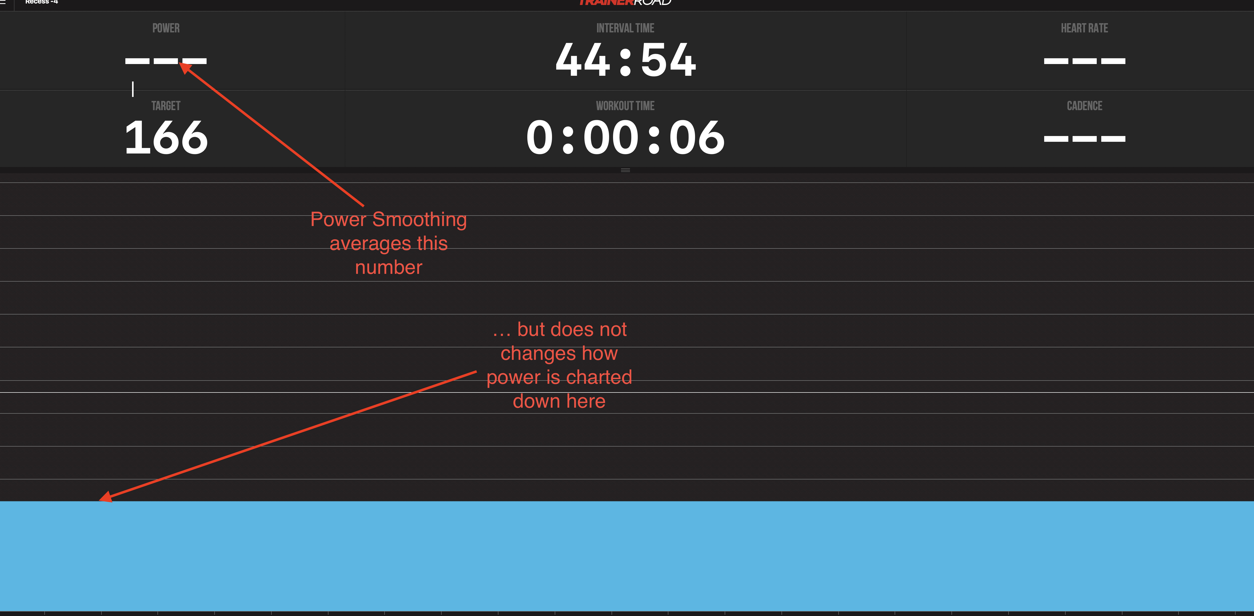

It smooths the live power display during the workout. It has no affect on Powermatch or the recorded data.
Ok, so this?
Basically correct. Power smoothing setting is for the number displayed in upper left.

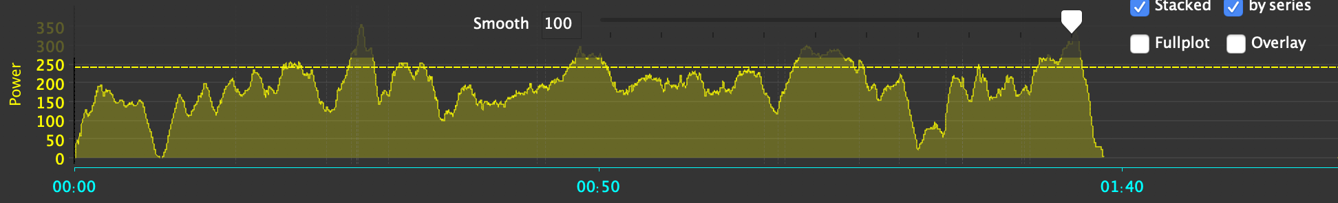

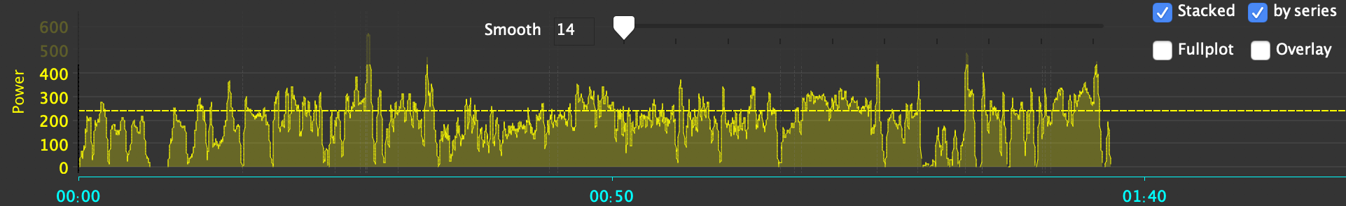

For example in Golden Cheetah you can control “visual smoothing” as shown below for an outside ride:
Smooth = 14
Smooth = 100
It is a lot easier to see power output trends when smoothing is increased from 14 to 100. But it doesn’t change the recorded data, its just a visual display setting.

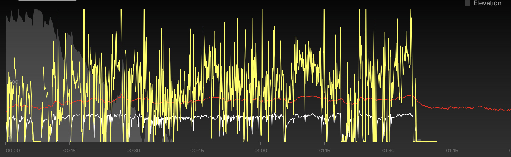

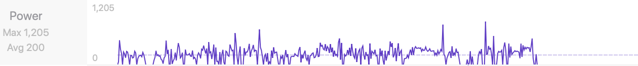

For reference, here are two other views of the same power data:
TrainerRoad
Strava

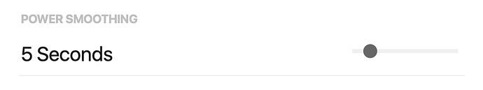

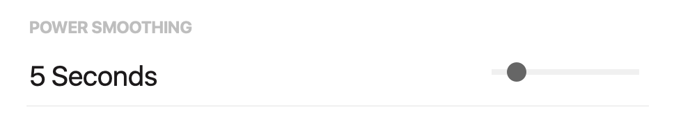

Re: does it work in TR app? Inconclusive. I’ve run TR app at same time as Edge 520, with both set to 10 seconds, and they didn’t match. After the workout the power charts match. But I just looked and somehow TR app is now set to 5 seconds (my bad). So not sure if its working as intended or not. I don’t find power averaging useful in Erg mode, so its not something I’ve paid much attention.

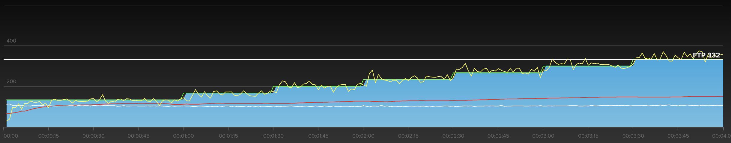

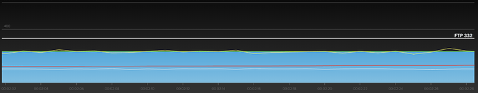

Ok, here is my experiment. I made a small ramp test starting at 40% and ramped 10% every 30 secs up to FTP. In the first test I set power smoothing to 0 seconds in the TR app and in the second test I set it to 30 secs (the max). Kickr power smoothing was turned off in both tests. I used Stages Gen 2 Left power meter in powermatch on a Kickr18.
Test One (0 sec power smoothing)
Zoomed into one of the 30 sec segments

I can’t really tell any difference in the way that the power is charted. I don’t think power smoothing makes any difference here. The number being reported on screen did seem a bit more stable in the 30 sec smoothing test, but honestly it was minimal.
Correct, as stated above power smoothing is only about the power NUMBER being displayed (and not power charting).
