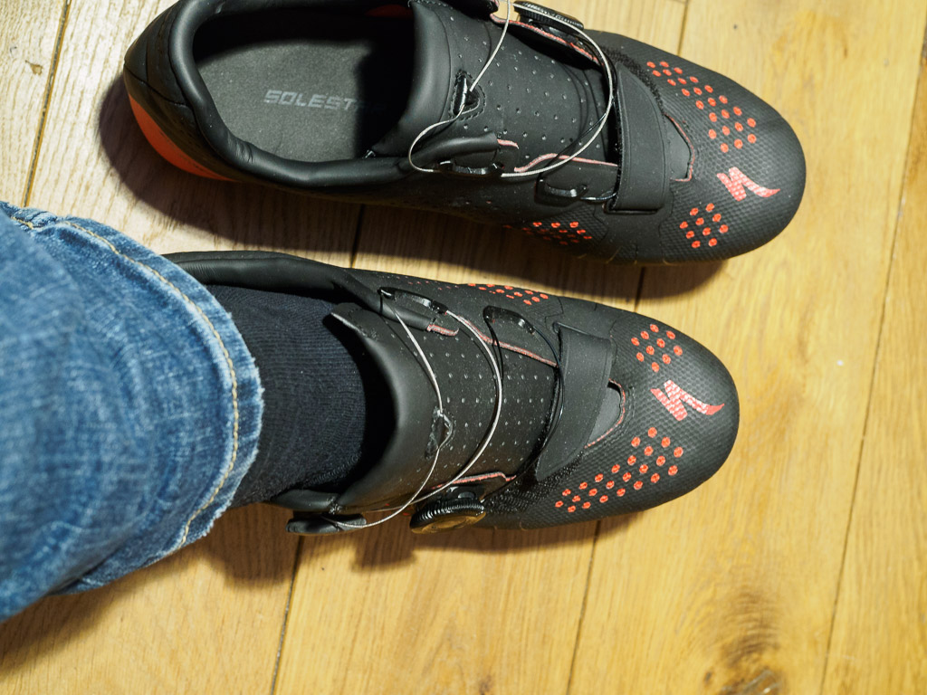

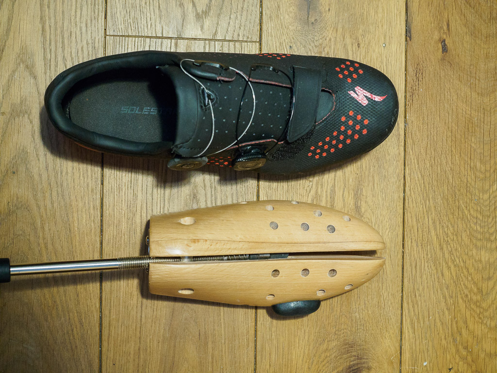

The shoe seemed to fit perfectly but after around 45 minutes I got hot spots on the outside of the feet. My initial idea was that the feet are swelling and therefore the shoes becomes to tight. I have worked with a shoe stretcher but with limited success. The cleat wedges brought the break-through.
Several steps:

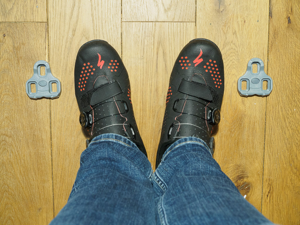

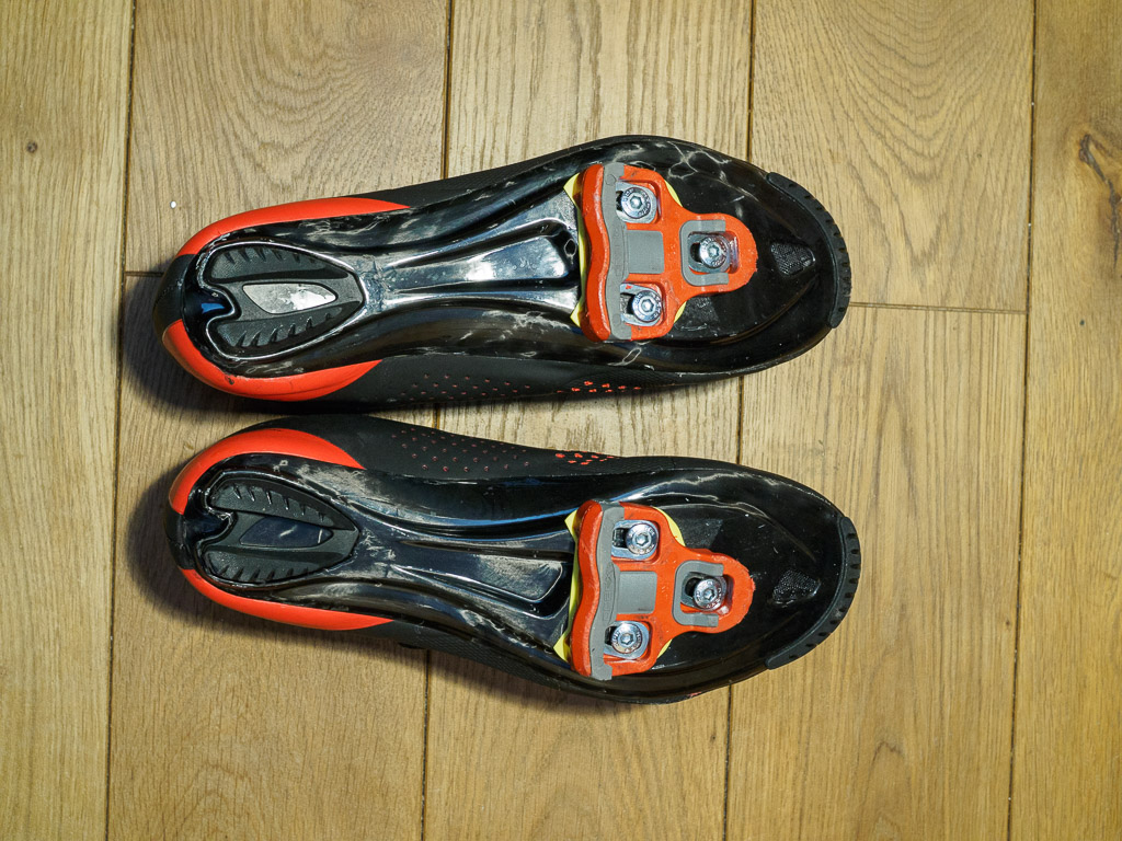

  1. I have “duck feet”. Therefore cleats have been positioned to accomplish for this - despite float of cleats. They are positioned as far as possible to the back.

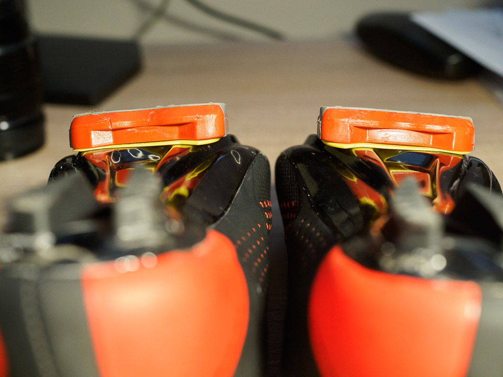

  2. My pressure of the feet is on the outside (Varus forefoot). Therefore I added cleat wedges to increase height on the inside to distribute the pressure. One or two degrees should be sufficient. One worked for me. I still need to see for rides longer than 2hours but up to 90min I am fine. Other shoe manufacturers seem to integrate the “angle” in their shoes as most people fall into this pattern (Varus forefoot). The Torch 3.0 seems to be neutral.

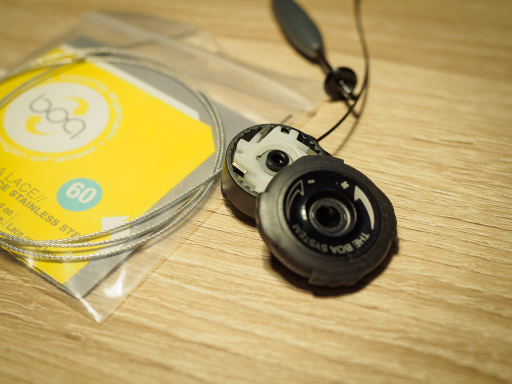

  3. The upper Boa cable is much too short and you can only get in and out with unhooking the Boa laces. I asked the Boa support for a longer replacement but only got the same length twice. I have ordered a 60cm Boa replacement lace for a different Boa type and replaced the lace (just the lace inside the Boa) myself. Now, I can get in and out with just loosening the Boa dial.
  4. I have replaced the insole by a Solestar kontrol, which I have order at the same time as the shoe ( I wanted to try it regardless of the shoes). The insole feels nice but did not have an impact on the hotspot.
