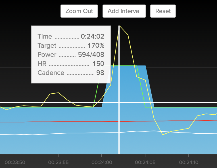

After reading the “do you switch off ERG mode?” thread, I thought I’d zoom in on yesterday’s Ebbets workout, as I noticed that the 5 second bursts seemed to be fast-reacting and on-target.
So my example, zoomed in below, is a 5 second burst from 233W to 477W on a 2017 Kickr Snap in ERG mode. You can see that the actual wattage (yellow line) ramped up to the 477W target 1 second early and fell back to 233W also 1 second early. The net effect is a full 5 seconds at the target., which was pretty much the pattern for the whole workout.
Note that the following 233W “valley” is matched perfectly by the Kickr Snap, I think this is helped by not running a super-high gear (I used 50-16).
When the following valley is much lower than 233W, say, 110W, the flywheel speed means I get a 0W reading for a few seconds before the resistance “catches up”, so for workouts with bursts that are interspersed with very low valleys I just select a lower gear to reduce inertia and minimise this zero-effect.
For the record (for other Kickr Snap users) I use a Vittoria 23c turbo tyre at 100psi and have 2.25 turns of the knob after tyre contact. Spindown is usually around 12 seconds. I have never once had a slippage. All in all I’m pretty impressed by the smart trainer.

The point I was making is that the claim that smart trainers in ERG mode are incapable of changing resistance in very short timescales (eg for sprint bursts) seems to be a myth, at least on my sample of n=1.

Powersmoothing is very likely on for you then, it comes as on in default with wahoo trainers. I’d recommend you borrow a phone and connect it to that and turn it off.
My power with 7 maybe 10 second smoothing varies greater than +/-1 watts more like 5 watts. We aren’t robots power output isn’t smooth.
Based on the image in your OP I’d say undoubtedly you do have power smoothing on. I have a Kickr and if I don’t have Power Match on my TR output looks pan flat like yours despite my head unit is bouncing all over the place.
If you look at other’s workouts and you see a perfect target to actual curve they are likely using a Wahoo trainer in default smoothing.

Wahoo power smoothing is turned on by default, once turned off the curves will look different.
From my experience, if you use a small chainring up front and middle to large gear on the cassette, the slower flywheel speed allows trainers to react pretty fast, even in power match mode. However, if the flywheel speed increases they start to react slower.
Also you definitely have power smoothing on. No one can pedal that smoothly. If you turn it off just know that you get the same workout even if you are nowhere near as smooth as it appeared when the smoothing was on.
