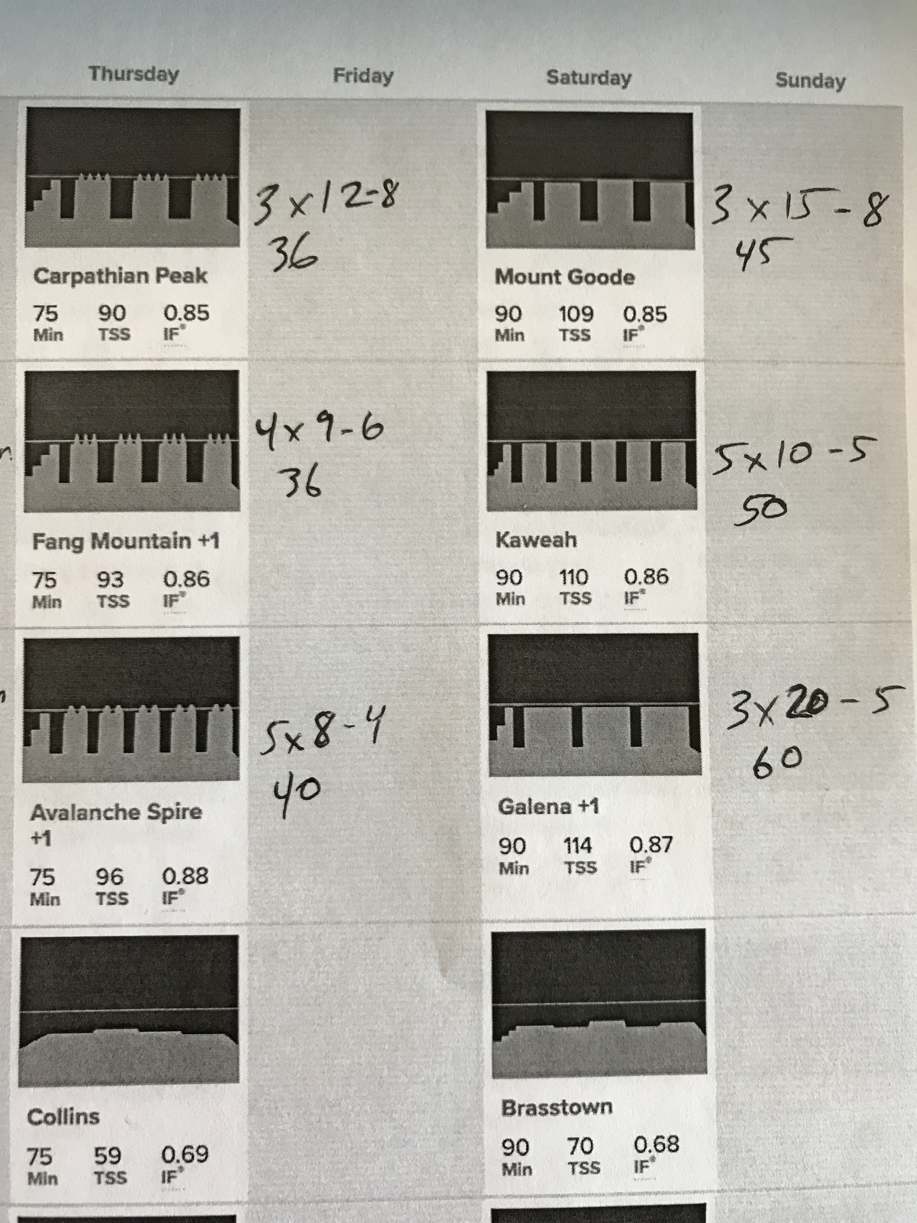

I am pretty new to TR and I am on the medium volume general build plan. I just did Baird+6 today and I saw in a couple of weeks I do Bashful+6. Looking at the little picture they look identical. Reading the details I see they are identical except Bashful has 8 minutes of recovery between sets while Baird has 5 minutes. The interval efforts differ by only 2% of FTP. The total TSS are different by 3. So, I looked around at more of the workouts and I see that there are many other groups that are almost the same. Why? I don’t understand? Is there really a need for both a Baird and a Bashful? Do they really have that much of a different effect? Or is it just padding the list of available workouts? When and why would I chose one over the other? I’m not criticizing. I am just trying to understand how this stuff works.

That 2% diff and/or that 3min inter-set recovery could be the difference between requiring backpedals to finish or not. When on the edge, that 2% might be enough to break you. Those extra 3minutes might make it so you can actually finish the next set. Etc…
Basically, while they look quite similar, the slight differences might make a difference the difficulty level for riders who are right on the edge. For some both will feel the same which could be hard or easy depending on fitness. Also, there is a mental component. No matter the workout, 8minutes seems like a LOT of rest to me, while 5min seems about normal.
The workouts are designed to progress in difficulty as you progress through a plan. So gradually increasing work intervals and gradually decreasing rest intervals. If you just look at workouts on their own they may look pretty similar but look at where they fall in a specific plan and it should make more sense. Also compare the IF of the workouts and that will guide you in level of relative difficulty
My guess is that the medium volume plans require you to do back-to-back sessions. The building level of fatigue during the plan could crush many TR users if the intensity increased too much.
Keeping the fatigue in mind, that workout might look similar now but it could be a real challenge when you get there.

The SSB programs progressively build in their demands so the effort level might be the same, but the intervals longer every week. It might seem like small steps, but it means you get a really nice progressive improvement in how long you can hold a given power target. I used to do my own training plans and basically did the same sessions every week and whilst they helped me improve, it was nowhere near as effective as the TR approach (IMO).
Trust me, when you’re right on the limit, panting like a dog, chewing your handlebars in desperation to get to the end of an interval, even 30 seconds less (or more) of a rest valley or 1% more or less of your FTP wattage can make a BIG difference.

It’s all about progression… sometimes the smallest of differences in rest time or effort level is the difference of nailing the workout or the workout nailing you. For me personally, I use past workout as benchmarks… if I completed a workout with slightly more rest or a little less intensity, it gives me the confidence for the harder work the next week.

Those two are more different in the low volume plans. Bashful ramps up to a target of 125% which is a big difference from all at 120% the week before.

In my personal experience, choice is a great thing. I did Baird +2 this morning after doing Baird last week. The difference in the extra 30 seconds “on” in +2 made for an entirely different experience (harder). If looking for or substituting VO2 workouts the FTP % and on/off durations are all variables I look for.
